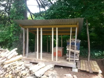

So i'm out there around the shed cleaning up and it's very windy yesterday, and I notice the wind (not in winter) generally comes from the south/southwest. So I decided to orient the shed accordingly. I setup racks along both sides, the long back, and two additional rows front to back with 10" between. This way i'm hoping the shed will catch the wind from the front and it can circulate through rather than having full front face blocking the wind. Pics to come.
You are correct.. my shed is facing south(the open part) the back is more north.. so the snow and winter rain beat sown on the back.. the front gets all the southerly winds ... you need to make shore the back and sides are vented to allow the wind to work through to help drying..my back is vented every 2 feet from bottom to top...the full lenth of the shed..

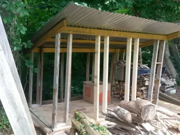

So I oriented the stacks from front to back leaving a 9-12" gap, depending on split length. Of course this means when fully packed, I'll need to pick from the one end so I need to sort by first use right to left.
I made a raised landing at the loading side out of scraps so I'm not standing in mud/snow while loading.
[Hearth.com] Reconfiguring Woodshed[Hearth.com] Reconfiguring Woodshed
I loaded the deepest two racks and I didn't foresee the added difficulty of loading when the side access is blocked. But that shouldn't be an an ongoing issue. I just need to remember to put my dryest wood up front.

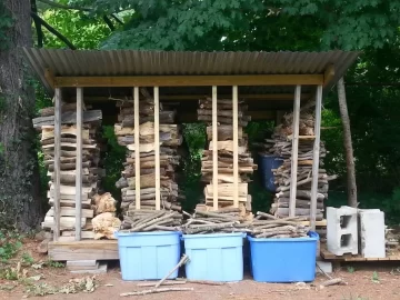

Fill'd 'er up. Most of the right side will be used for outdoor burning in late summer/fall. Airflow seems good.
