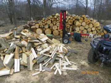

gyrfalcon, never try to lift that stuff. Look at the size of a couple of these rounds. The ones just to the left of the splitter. Click on the picture to get full size:
[Hearth.com] Red elm/slippery elm seasoning question
Those big rounds are red oak. They weigh over 200 lbs each. The heaviest one that I weighted was 252 lbs Now realize that I cut the wood then haul it out on the trailer and stack all the winter's wood. Then in spring comes the splitting. Yet I can tell you I never lifted one of those rounds. It can be done but why would anyone want to lift them? My back certainly would not like it. And for what it is worth, my little weakling of a wife moved several of those rounds all by herself; rolling them of course.
Getting those up to a 6" height is quite easy. The way I would get them up the 6" is to lift only one end up then the other but never lift the whole thing! Many times getting a big round into a trailer I will set a small round behind the trailer then sort of step lift it. That is, first put one end on the round and then lift the other end (cant hooks can come in very helpful sometimes). Then put one end on the trailer and then the other end. You can amaze yourself sometimes how much you can move once you get the hang of it.
