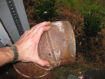

The pics are of the old pipe(this I why I never throw anything away..until the new thing is working and has been working!)

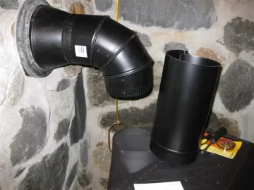

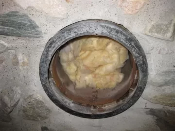

The thimble, and my setup...with the ill fitting reducer/expander.

Do you have Selkirk Metalbestos brand chimney pipe? That first pic sure looks like a Selkirk finishing collar. If so, remove the finishing collar and get an 8DSP-CPA chimney pipe adapter. It will twist into the first piece of chimney pipe and provide the 8" male connection that you need. The finishing collar and screws will lock the adapter in place.
You're on the money Ron! Good eyes! Now I know what those raised "fins" are for inside the pipe.
Looks like there aren't really any Selkirk dealers that are local to me. They list "Lowe's", but a quick search only shows them as carrying 4" pipe and adapters. I guess this is something I'll order online. It probably can't hurt to order a new finishing collar too...that current on is pretty rusty.
Oh, and a big "thanks" to whomever built that hearth. They cemented a stone right in front of the last screw that needs to be removed to get the collar removed. I may end up cutting it off...or chiseling the stone.

Thanks for your help! I ordered the part yesterday along with a new finishing collar.
RS267 said:
Excellent! Glad I was able to help.
Huge help Ron! The part came Friday, I tossed the box in our Jeep and we headed to VT. I tackled the install on Saturday. The part fit like a glove; twisted right into place. The reducer the slid right on to it! Sweet! Thanks again!
