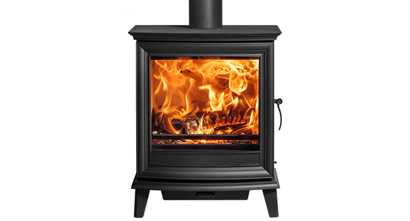

The stove I have been looking at is a Chesterfield 5 Wide Model.
I can't seem to find it in America though. If you click on the "Tech Specs" it's clearances are in range. It states with a heat shield it can be 2 inches from the back wall. The wide unit is only has a 14" depth. And the font space clearance shows 7-9 inches depending on how you install it. That is the closest thing I could find close to fitting my situation. That would be 23-25 inches total. The problem is I can't find a place to order the stove from. I wonder if there are more Wide style stoves in America that I could look at with similar clearances.
Stovax stoves are not sold in America to my knowledge. They are not EPA approved.

I can't recall one like that now for sale. The Chesterfield looks like it would spill smoke everytime the door is opened unless draft is very strong. The Morso 7110 might work, but it is smaller. It qualifies for the 26% tax credit.
The Jotul F100 or F3CB would have come close with a rear wall shield.
