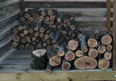

Here's a pic showing some of the cracking on the ends so far.

I would split all those bigger pieces and give it another year anyway.
Ah, I explained that in my post in the woodshed thread, but not here in this thread which is most unhelpful of me. I just loaded a bunch of cut logs at the front of the woodshed just to get some weight on it so it doesn't blow away. I'll split them as time allows but they sure are losing moisture so far as-is. The stuff towards the rear is all split or 4-5" diameter or smaller rounds that I don't intend on touching again until I burn it.

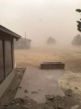

You know very well how dry and windy it can be out here!
For a visual of what windy and dry can look like. Taken today. I grew up in this house on the KS/CO border. One dust storm was so bad we had dirt drifts 3-6’ high. I believe that was 1988.
