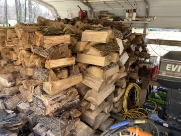

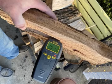

Here is some oak and hickory I cut and stacked back in the spring. (March)
Metered in a fresh split. NC has long hot summers, and under a metal carport for a shed, that metal roof puts out some extra heat. On hot days while working outside, you might think you want to get in the carport for some shade until you actually try it. It’s noticeably warmer.
Anyway, this wood isn’t a year old yet.
