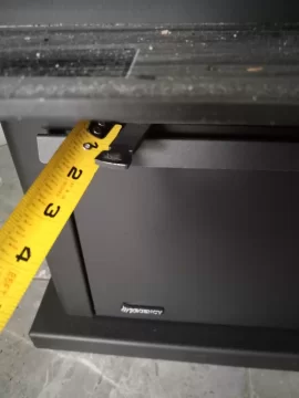

The installer has already come and removed the deflector after reporting the backdraft issue and it seems to have helped a bit but still having some smoke issue when fire is running hot and open the door to add a log or two. My main issue now is the damper rod jams when pulled all the way out and I have to hit it back in to start to close the damper. Im thinking its not even opening all the way when it jams. Does anyone have the insert i2450 and can advise how long the stroke is from all the way closed to all the way open?
Sorry I can't comment on the damper stroke length as I think my control is different than yours.
When you're burning hot and you open the door a crack, does smoke pour out the entire time the door is open (suggesting it could be draft-related) or only for the first few seconds (meaning draft is fine but your damper control suspicions could be correct)? That's just a thought I had, but someone with more experience or knowledge please correct me if I'm wrong.

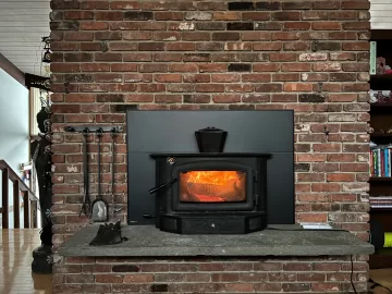

Chimney is straight up no real bends in the liner. House is a split level. Chimney is 15’ and the stove insert is on the second floor which is about 6’ above ground level. Fireplace is about 18” off the floor inside a very large chimney. Here’s a photo of the insert.

That setup is normally not an issue. Are there any strong exhaust fans running in the house in the kitchen or bathrooms when this happens?
Try opening the air full for 5 seconds before opening the door, then open it just a little at first, then continue opening slowly.
I’ve tried that. Nothing really helps. Very occasionally, I can get it open and not smoke but as soon as I try to put something inside, it smokes.
There are strong fans in the house but they’re not running when I try to open the door.
Does opening a nearby window an inch beforehand help reduce this problem?
Would it be possible to add a 2-3 ft extension to the chimney?
