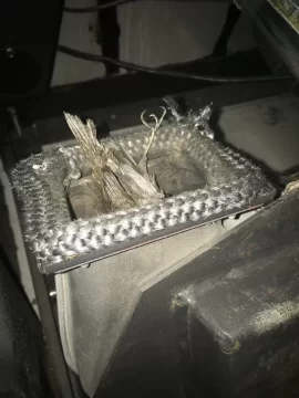

So, as stated many times, airflow is the key and all the parts of the stove have to be working or it will throw a error code. If something can happen to a stove, it will happen to me. Here goes my story...
I turned on my stove for the first time this season. GCI60, Hampton(same as Enviro M55). I got a number 2 error so I started off with a deep clean. I mean I cleaned everything to a "T". Then I checked all my gaskets and the pressure sensor. All spotless. Everything seemed to be in order. After running out of options, I put in a call and an email to the guy that installed the unit...10 days no return call. He's a great guy, so I'm sure he's just super busy right now. Days go by so I start reading posts...again. So, I continue on with checks and extra cleaning...
I read here and in the manual that it could be the combustion fan. When I took it out the first time everything looked fine.
This time, I reached into the fan housing and tried to spin the wheel. I thought maybe the motor was bad. I felt something that felt like a very small twig. Strange, but I couldn't see it and the fan blade seemed to be moving freely. I spun the wheel a second time and a bird popped out. See attached pics. Yes, a bird had ended up in my combustion fan. My chimney pipe is about 40' to the roof.
The important thing here is that unless I reached into the fan housing, I would have never found the bird. I had my stove out at least four times and never reached into the fan housing.
I cleared the bird out, vacuumed the fan housing out and bam, unit runs perfect.
Murphy's Law. Never underestimate just how nutty things can go.
I hope my saga helps someone out and saves a service call.
