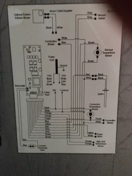

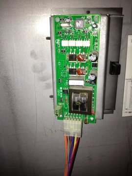

Attached is a picture of my circuit board and circuit diagram that is next to it. I was looking at the Skytech 3301p thermostat, in that case would I just run 2 wires from the green thing on the circuit board to the receiver of the thermostat and program the remote? I know wired thermostats are much cheaper, so are they any more complicated to hook up then the wireless one? If i get a wired thermostat do I need to run power to it?

Yes you would attach your wires to as you call it the green thing you would do the same for a wall mount thermostat you would not need power for a wall mount.

I didn't know what else to call it! Thank you. For future reference, what would it be called?
I use the Lux TX500U on my M55-C-FS
It is a wired thermo. I have the thermostat in a separate room from the stove.
Connections are just two wires.
The Lux Thermo has 2 AA batteries in it for power.
Think of a thermo as a switch. All it does is allow signal to pass thru it.
The brains of the thermo control when it switches.
In Stove Hi/Low mode
The stove basically just waits for the switch to turn on/off in standby (idle) condition.
When the thermo senses room temp below its turn on set point it closes the switch and allows the stove to ramp up to whatever power level it is set to for running mode.
Once the thermo senses room temp above its shut-off point it opens the switch and the stove goes back into idle condition.
About the only difference between wired or wireless is "the two wires" and ability to place the thermostat where ever you want.
The connections at the stove will be the same.

The Stove Manual shows where on the stove control board to make the 2 wire connections. Polarity doesn't matter.
