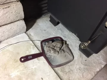

Regency H2100 Hearth Heater owners just a heads up, I have been having problems with the stove not getting enough air the air control rod was not working. I was just doing my yearly maintance and cleaning on the stove and took a flashlight and mirror and looked up the side heat shields and noticed there are air inlet slots going into the stove so I took a 3 foot piece of bailing wire bent a small hook on one end and fished around into these slots and when I pulled it out there was a massive dust clot I pulled out pictures below.
[Hearth.com] Regency H2100 Hearth Heater
Wow, that'll choke the stove some. Looks like a major dust bunny.
