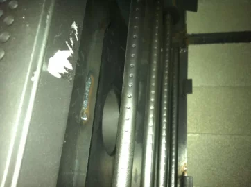

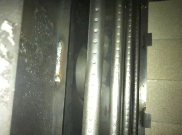

Hi everyone new to the forum been browsing here for awhile now. Got my regency i2400 installed today was about to start my first fire and went down a safety check. I think that I am missing the top baffle plates any other regency insert owners can confirm this. I attached a pic hopefully it will show up.

Yup. You are correct.
I would bet that you got the display model. They took the baffle for a warranty in a pinch and forgot the replace it. Just speculating here.
You will not want to burn it like that!
Ok thanks for confirming this guys. I was really looking forward to using it this weekend I am glad i looked it all over before i started it up. Hopefully they can get the baffle plates in asap.
