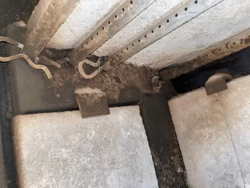

So, the stove has been up and running for a few weeks now. Plenty happy and plenty warm in the house. With that said, the piccolo tubes at the top of the stove keep coming out of their mounting holes, if you're not extremely careful not to bump them by a log when packing the stove. It's a pain to get them back in place with a hot stove, to say the least. At this price point, I'd not have expected something like this. The issue appears to be the notched side of the tube isn't notched enough, so it only sits with a quarter inch or so of notch. Is there a fix other than not to bump them.

Are you driving the tubes all the way in by putting vice grips on them and smacking them over into place? If yes and they are still coming out just squeeze the notch closed a little bit so they latch in tighter.

That's probably the issue. They take a fair amount of force to drive into place. I believe the procedure is in your manual

Hi Pedro, you can hit them pretty hard. After a few hits, check the tube by hand by attempting to remove it. If it doesn’t move, you should be set good. If not, see the post above on slightly compressing the end of the tube, so the notch catches as you tap it in place.

It takes quite a bit of force. It should slide in a little bit then pop into place going over about another 1/4". The notch should be bottomed out.
If the notch is bottomed out but the tube is still loose squeeze it closed slightly no need for a new tube at all
Just wanted to report back in - followed advice given, and had same results as OP.
Slightly crimped the end of the tube (end that has notch cut out), clamped on the vice grips and drove it home. I put some hash marks on the tube with a sharpie, just so I could see how far it did (or didn't) go in. Looks like it went in at least 1/2". The tube would literally fall out every day, between 1 and 12 hours into a burn. Has been in now for over 48 hours. Wonder why the fieplace company I purchased this from and subsequently had it serviced by didn't know about this fix....
