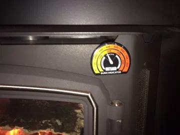

I have never really got my heat over 350 so I was wondering what type of thermometer you all are using and where the proper placement on the stove should be to get a good reading.
Here is a picture of where I have my thermometer.

I'd move it down so it's closer to the door. I have ours on the left side, but I don't think it makes any diff from side to side.
One thing about those magnetic thermometers, they are notoriously inaccurate. If you can, put it in the oven for a while at say 300F and see if it's close. Then you'll know how much to allow when it's on the stove.
The thermometer in the oven thing is a good idea.
