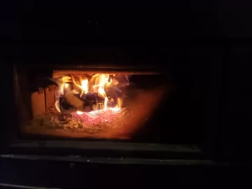

I get this black mark on the glass always at the same spot....lower right. I just cleaned it today and it reappeared on the 1st burn. Why only there and how do I prevent it always happening. Thanks.

I dislike you strongly. (hate would be too strong of a term)
LOL Im joking of course, but coming from Vermont Castings um, this would be something many strive for and be envious lol.
Do you have any elbows in your stove pipe configuration? Have you checked the gaskets on the door using the dollar bill test?
A leak in an area where the black mark is, could be the culprit.
But there are so many other reasons. Could just be how you are oriented your loads. Be sure to give that glass some space.

What model Regency is this?

It's a fireplace insert so no elbows. What's the dollar bill test?

What is with the VCs? Do they just not have a good (or any) air wash feature?

I have an I2500. I get a similar issue if my wood gets too close to the glass. Additionally, I find that the edges of the insert run a bit cooler than the center. Since the Air intake comes from bottom center, the middle gets going fater than the edges. I would make sure the outside pieces are really going before closing the air down and put shorter pieces on the outside if you have them.

The dollar bill test is put a dollar bill between the door gasket and the stove. Close and latch the door.
Pull the bill and notice how much resistance you have. If the bill slides out with no effort, your seal is not as tight as it should be.
That would mean an airleak, cooling down the gases there by introducing cold air (rather than preheated air). This will result in incomplete combustion and creosote deposit right there. Hence brown spots.
Do this in multiple places around the gasket of the door.

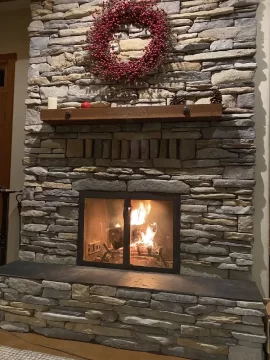

I think only choosing a mobile phone plan is more painful than choosing an insert!!! I'd probably go for the Regency CI 2700 if it weren't for all 'instantaneously' black glass reports. We're replacing a fireplace with full flame view & the last thing I want is to be staring at a black hole in our living room focal point.
We have lots of access to dry wood as we harvest our own, but would want to run an insert 24x7 and do long (low) burns, especially overnight to offset propane costs.
I see the complaints, but has anyone succeeded with the air wash & pleasantly clear fire viewing with dry wood & long low burns?

Thanks for this! (And thank you--I'm pretty set on not totally destroying the aesthetic the original owner/builder realized!)
> "I resolve that easily, however, by burning on high for half an hour to 45 minutes."
I take it you mean that this burns off the black, doesn't prevent it? It would be nice to do that in the morning to clear the glass & enjoy flames during the day.
> "The air forms a decent sheet in front of the window on burns using more air."
> "BK stoves don't keep their window clean in the lowest burns."
Based on your BK experience, is there a mid-rate burn that supports the air wash? How long a burn would you get from it with your setup? Maybe we could use that when we're around to see it. (I know, many variables & a loaded question. It's just hard to only work in the absolutes at both ends of the spectrum.)
Really appreciate your time!
