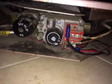

Update: I took pics of the valve and the circuit where I removed the SPST switch. I also just basically moved some of the wires around and also vacuumed the dirt from the area as well as around the insert. Once I did that, it now seems to turn on and off as expected (when I connect or disconnect the black/white wires in the attached photo). Still don't know how this is really resolved, but I guess I will throw the switch back in and reassemble. Hate to do that without fully understanding the cause - intermittent issues are not easily solved for long term reliability.
FIRE245 - Doesn't a thermocouple convert heat to electrical energy? So - are you theorizing that the leads to the thermopile are shorting prior to the pile then the voltage will always be zero? I would have though the gas valve would have handled that as some sort of "error" because I think a thermopile always puts out a voltage signal whether there is flame or not. I suppose that it could be the voltage "drops" when the flame is on the pile, and hence perhaps a "zero" would make the valve think it should remain on? not sure.... but will take a look when this happens again and measure the drop.
