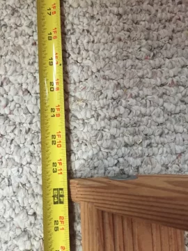

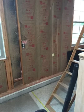

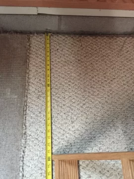

We are converting a attached garage into a living space and hope to put in a vent free gas log insert. The depth is where we are limited roughly 23 inches. This is due to a pull down stairs that will only allow that amount of clearance.
Will we be able to fit something in this space?
