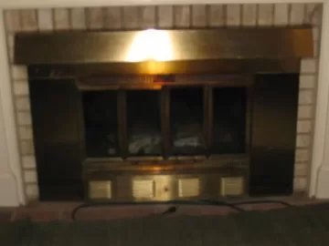

Thanks for the swift response and advice.
I've attached a photo of the insert.
What special tool do I need to remove it (apart form the dolly)?

Yep, steel stove. You'll need some screwdrivers to remove the shroud, surround, detach pipes, etc. Then the aforementioned instruments. It might help to have a pry bar or two on hand so that you can slip the edge of the steel sheet under the stove. Once the surrounds are off it will be pretty self-descriptive.
