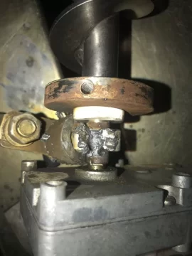

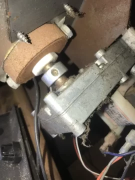

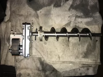

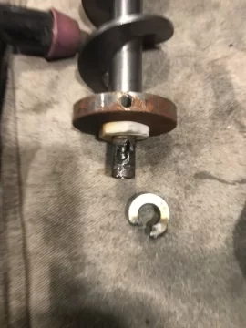

The auger and auger motor did come out in one piece.

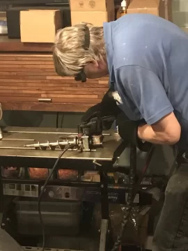

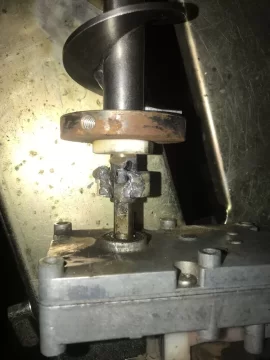

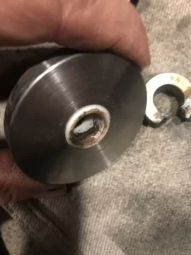

The auger steel set collar is really stuck and the set screw head is gouged out completely!
I tried drilling the set screw but not much luck. :-(

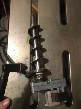

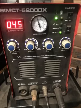

So I pulled out the plasma cutter. See pics
Easy to cut but hard not to cut the auger. The bearing was very dirty inside so that was cleaned with a rotary brush.

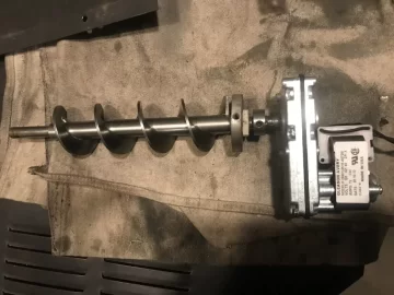

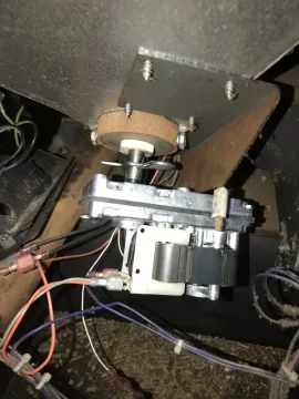

I just added a new set collar and auger motor.
Pellets should feed much better now?

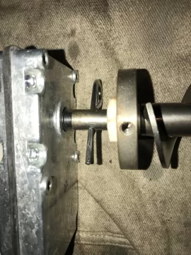

Hello

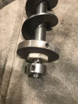

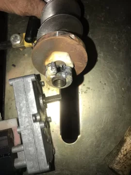

There seems to be an issue with just putting a new auger collar on the auger and re-installing the auger with a new motor.
Why did Napoleon switch to a hitch pin and an auger motor with a hole in the shaft in there newer NPS-45 pellet stoves??
The steel collar is quite a bit smaller than other pellet stoves and so is the set screw!
Ah Ha
So I drilled another hole in the auger shaft, got a 1/8” diameter hitch pin and an auger motor with a hole in the shaft. So bingo this auger motor will have no more issues when being replaced in the future!
