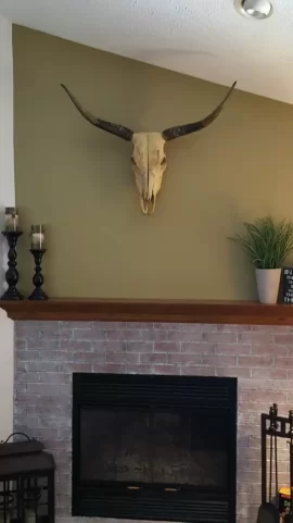

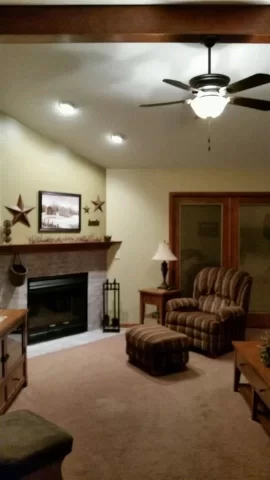

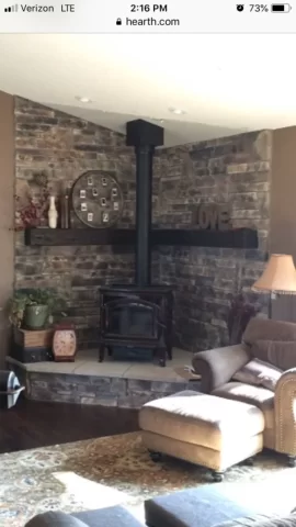

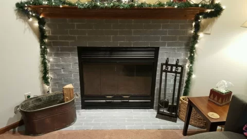

Ok everyone. I finally came to the conclusion that I want to put in a wood stove. I have a Majestic factor POS currently and I fear a failure or worse, fire with it. Plus as you all know it is horrible! So after reading and searching on here I finally convinced my wife to remove the fireplace and do something like another member did. The below pics are my fireplace and a member's woodstove from here.

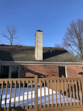

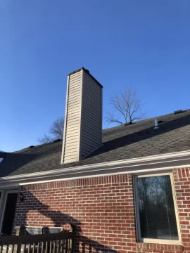

I can't get on the roof at the moment (too much snow and too cold)! I can possibly get some pictures of the pipe in the attic. I don't have a masonry chimney. It is all stick built, with what appears to "look like" a chimney sticking out and above the roof with the pipe coming out of the middle of it. It is all stick built and has siding on it.
I looked in the manual on the POS fireplace and its a Majestic, says to use SK8 chimney?
A pic from the ground MAY help. That won't tell about clearances & whether it is a proper install for a stove or not. You might have an insulated stainless chimney, but can't tell from your description.

The chimney on that fireplace is not suitable for a wood stove. It will need replaced.
This my my chase.

My two cents; If you can swing some cash, buy a quality stove (do your research.) You'll never be sorry you spent that money. Like they say, the bitterness of low quality remains, after the sweetness of a low price is long gone. That enamel stove in the pics you posted looks mighty nice.. ;)
