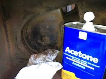

Hello
Well, I guess you know where I go from there, but here are the pics to show!
Knock down ash and rust with manual wire brush
Use drill/driver wire wheel to really get it clean.
Smooth down with emory cloth. Any ruffness in the chamber impedes air flow.
Clean up with Acetone
Coat sides and behind impeller with Dry Moly Spray.
Throw on some new impeller blades when the old ones are real rusty. Again rust impedes air flow. New blades are only $25.00
Coat both sides of new or old blades with Dry Moly Spray. Adds protection and gives a real slick surface!
Put back with a drop of oil on the set screw and bingo. A real professional Job!
Next time it will come off easy!
