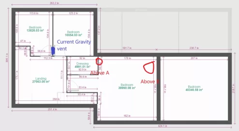

The renos are currently on-going with the sprayfoam being applied everywhere today. Looking at the plans in the old thread (attached below), we decided to shift things around and add an office/guest bedroom + dedicated entrance + restroom/laundry room where the garage is located. We will end with something close to a 2500 sf fully insulated house.
My SO and I decided to opt for a wood stove and not for a ZC unit, which will be located in zone B in the plans. I'm now faced with a decision: which stove to pick.
While the stove will be located in a central location/open portion of the house, I'm still uncertain about how the heat will flow in the house (the ceilings in the living room/dining room/kitchen are low (a tad more than 7'), and I'm trying to balance out the following 2 aspects for the woodstove: (a) I want to be able to heat as much of the house as possible with the stove especially when we hit the cold Quebec winter snaps of -35C, but (b) I don't want to toast the whole family while we watch a movie in the living room where the stove will be sitting. I understand I might be looking for a unicorn here...The previous 37k BTU Drolet (steel) was in fact toasting us to a crisp 28-30C when cranked up before the renos so I'm leaning a bit more towards cast iron/soapstone stoves at the moment.
