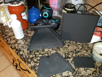

So i was just going to pull stove out to clean but decided to at least repaint the heat exchanger covers, flame guide and center medallion.
Started trying to clean heat exchangers and having a hard time getting them to like new clean. Was using imperial clear flame 2in1 glass and masonry cleaner so probably need a better product. The stove always gets a ton of ash on the heat exchangers and efficiency drops dramatically. Not sure that can be fixed but getting them as smooth as possible seems like best way to help make it so when clean i am able to remove as much build-up as possible. So thinking I may work on that but we ill see how far I get.
Next the burn pot could use some paint so may also remove that to paint. At that point may also see if can remove auger. Can't afford a new one as assume a bit worn as its noisy but think cleaning it could be beneficial.
Next the hopper lid stopped staying open a while back so may remove that to try and fix locking hinge but have just been using a butter knife to hold open without much difficulty so may not be worth it.
Most of the exterior paint still looks good so will see how well can clean up but may have to paint the bottom lip and possibly hopper. If matches then the rest of it should be ok. We will see...

I used CLR and scotchbrite pads to remove the rust on stoves I’ve painted, then water on a microfiber to rinse any residual. Acetone all of the areas you intend to paint and it will make the paint stick. I used VHT flat black on the fire boxes and burn pots as per Dons suggestions. It’s a bit of work but is definitely worth the time. Looks good so far...good luck and post your progress.
So first things first the heat exchanger covers etc...
Bought a can of Stove Bright 6903 will be here next week so going to try to prep the the parts for paint today by removing buildup and rust with wire wheel and sandblast.
Started with cleaning in sink best I could (which is partly why so rusty).
Then used table wire wheel but only so much can reach with that. Could not find a wire wheel for angle grinder or pneumatic grinder so just sandblasted. Was able to remove rest of hard deposits from flame guide and medallion piece.
Castings are so rough can't remove rust so at this point just going to soak in evaporust and see how turn out.

Ok just bought 2 cans will g pickup now so can hopefully paint today. Thanks
Edit, the VHT is ceramic coating so idk if really ideal for the heat exchanger covers. Or does it really matter...i mean is less heat going to transfer and more heat go up chimney? Seems unlikely...
Friend sent me a thing in elecolosis cleaning. Probably be the way to go had I planned this out better. Oh well.
What the heat exchanger covers really need is to be run thru a tumbler like they do with machined parts. The evaporust may help but did not have enough to submerge them all so not sure will be 100% rust free. Going to wire brush them best i can see if works.
As said the castings are so rough that even after painting still going to be hard to clean properly with all the nooks and crannies. But paint may help smooth out. Will at least look better then rust and I'm sure will clean a bit easier. At same time wonder if paint will decrease heat transfer efficiency...probably not a huge issue, idk

Used wire wheel on everything and sandblasted where could not reach as evaporust made more rust then removing, probably due to being old idk. Forgot to take pics of them prior to painting but wire wheel did ok job.. Wiped with acetone using the blue paper towels and then blew off with compressor. Best i could do for prep.
Got everything painted last night.
Doing yard work all day today so no more progress.
Bought CRC moly lube to spray in auger feed tube.
Still lots to do but glad doing a more thorough cleaning this year.
