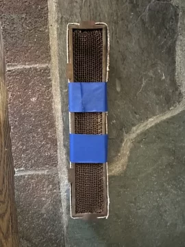

Hi all, I have a BK Ashford insert, does this catalyst need to be replaced? I assume this is from flame coming around the side of the heat shield and having the flame too much. It’s 2 years old.

I started a thread on 9/16 regarding the same issue (gap between catalyst and metal frame). BK replaced my catalyst under warranty.

Weekly update, still no word. Its really disappointing, started the process in September. I'd rather not waste a combustor gasket when I and/if I end up replacing it... But it's getting colder, any potential issues using that combustor with gap?

I'm not sure why you aren't getting any help from Blaze King. As mentioned in my earlier reply, I had no issues getting a replacement combustor for the same issue you have.
I probably wouldn't use the combustor but maybe someone else can chime in?

They only will warranty you one cat. In the meantime, buy your next cat from midwest on amazon and install it for now. Then when BK makes good and sends you the new one you can have it on the shelf for when the installed cat wears out. These things don't forever and are a consumable.
That's what I would do anyway.

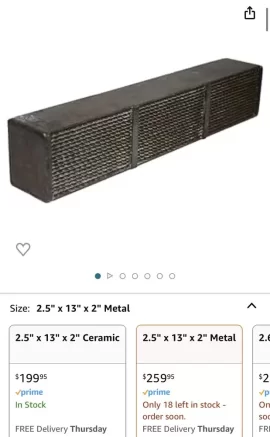

I tried Midwest several times but they do not offer a Blaze King S.CAT2425 OEM or aftermarket replacement. Midwest told me they never had this model available. My local dealer got one from Blaze King in about a week.
Many on this forum say to get one from Midwest, however most on this forum seem to forget that the inserts are not the same as the free-standing stoves.
This company has one listed and shows "in stock" (at least as of today)
https://hechlers.com/product/z0335-...rd-af25-insert-bx24-boxer-catalyst-s-cat2425/
This particular catalyst seems to be harder to find than most of the others - hence I have one sitting on my desk as a backup. The $410 price may seem high, however I paid near that for one two years ago. Prices will not be going down.
Search on the part number and your results may be better.
It’s too bad BK used an oddball cat for your insert. I was happy that they used the same princess cat on the 30 box stoves.

According to Hechler’s the combustor Measures 13″ X 2.8″ X 2″. Did Midwest Hearth mention if this would fit? Maybe I’m being hopeful and have Length, width and height mixed up. I sent them a message today and hope to hear some good news.

So they replied that they believe the ashford 25 hs a 13.5” combustor and it wouldn’t work. Do you or OP have yours out to measure?
I don't, I was just looking to grab one as a back up. I appreciate the fast response! It is crazy that you see Cats online for $200, and we have to pay over $400 for ours.
It becomes a consideration during stove selection. These things are wear items. Cost and availability matter.
