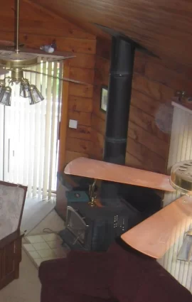

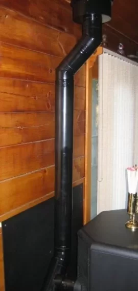

I have a log home as well, along with the great room. I replaced an Elmira Stoveworks wood burner with a pellet stove and never looked back. Adapted 4" pellet pipe to 8" MetalBestos stove pipe.
  • [Hearth.com] Replace wood with pellet stove?
