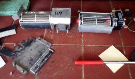

My stupid camera had a low battery, so the flash didn't work, and it was a low-light situation, so I have fuzzy photos. I used the wife's phone to record the noise, but haven't received the files from her yet. Will post when I receive. Here are some pics that ought to help somebody.

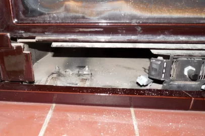

After a LOT of investigation, mirrors and flashlights, I discovered that the fans are held in place by two clips. Slide the fan forward, and push the heat-shield upward (with the fan), tilt the fan upwards, and work it out. BION, it comes out. Fascia can stay in place. Of course the grate comes off.
Here are the retaining clips.

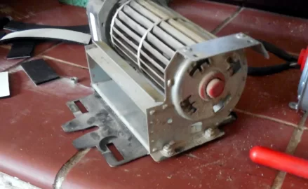

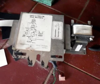

Here are the differences in orientation of the power leads, and the plate that needs to be re-used. Of course, the blower side points inside the stove.

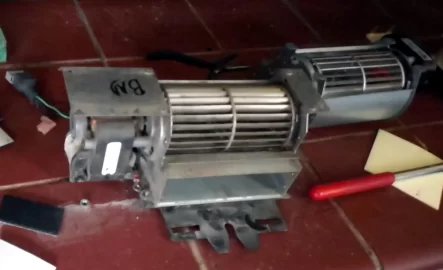

Here's a good representation of the differences between the original and replacement. The replacement seems to be missing a secondary heat shield. Note the difference in the orientation of the power leads. I found it quite helpful to label the connectors for main and right hand side. I had to bend the tab to get a 7mm socket in there to get the locknut loose.
