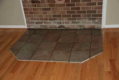

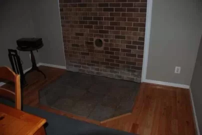

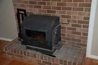

Hello,

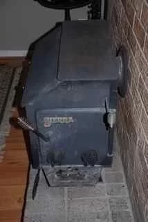

I would appreciate some help with finding a new stove that fits into where our current stove (Sierra T1000) sits. Here is the situation:
Location: Outside of Annapolis, MD
Use: Major heat source of heat for the house during the winter when our heat pump can't do it alone
House: 2 story, approximately 2000 sq ft (colonial, built 1985) with a draw-thru duct to bring stove heat upstairs.
Room: 1st floor in a large dining room / kitchen / play room that covers the entire rear of the house (8' ceilings)

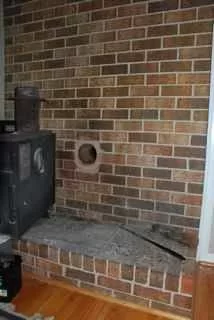

Hearth: Brick, 21" D, 67"W, picture below
Flue: 6" and the center is located a 20 1/4" above the hearth
I am starting the search for a more efficient stove and I am immediately running into problems.
I know I have to have a side loader because of the local building code (hearth depth). So, with that criteria locked and my 21" hearth depth and flue location, I can't seem to find a new stove that won't require me to either make my hearth larger or move my flue location.
My local store suggested my only option is the jotul F118, which isn't the look my wife and I like.
If I do have to make a physical change to my hearth, I figure a new flue is easier than adding on to the front of my hearth?
Thanks for your time.

Rear-exit steel stoves are rare. I'd consider a Jotul F500 for a side-loader. A Woodstock Fireview might work there too. The hearth can and should be extended. The easiest way is to do this at floor level. It's not exactly kosher as it stands now, so I'd plan on this regardless of stove choice. A hot fire in a stove can radiate a lot of heat from the front. Also, the thimble location can be raised to allow the installation of a top-vent stove.
The Newmac NC 100E is a side loading, rear exit stove that is EPA approved.
(broken link removed to http://homehardware.ca/Products/index/show/product/I5530913/name/)
Go here and click on EPAClassic series:
(broken link removed to http://www.newmacfurnaces.com/showroom/index.html)
I'm not sure how high the centre of the flue exit is.

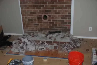

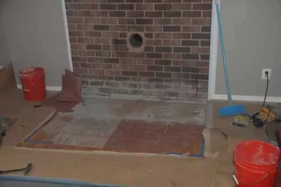

So, Mrs. Joeggles and I have finally decided upon all the things having to do with the "hearth project". The tiles are here, we picked up the sheet of Micore 300 the other weekend and we had family in town this weekend to help with the little joeggles....so to work we went...
First, smash up the old hearth....lots of noise and lots of dust...
  • [Hearth.com] Replacement for Sierra T1000 problems

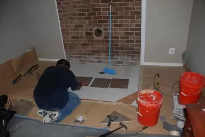

Then cut into our nice wood floors to make room for the new hearth...

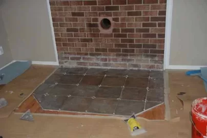

And thanks to our able assistant (read he did all the hard stuff) Phillipe, we figured out the layout of the tiles that pleased Mrs. Joeggles the most

Of course we had a 1/2" sheet of micore 300 on the bottom, then a 3/8" sheet of durock..then tiles...here it is before the grout
and after some area cleanup

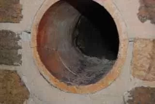

stoveguy2esw said:
while you are in the project mode i noticed in the last picture on your origional post the thimble tile is cracked, might want to address that while you are in transition
Now that is a good catch. I haven't thought about that detail in a while. Last I remember talking to the guy who will eventually line the chimney and install the stove...as long as we use a single wall metal thimble...the cracked thimble tile isn't going to be a problem.
Is that not true?

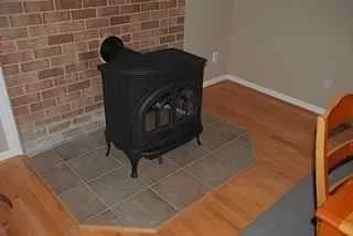

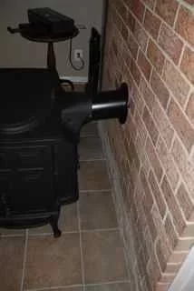

Here is our new F600 installed. Front view and side view.
I think our only problem with the installation is how far it is sitting away from the wall. The stove came up about an inch lower than the opening in the wall, therefore the installers had to set the stove so far away so as to be able to slope the thimble up to make it through the wall. They also removed the cracked ceramic thimble that you can see from the original post. That bought us a little more room, but as you can see the stove is still sitting much further than required from the non-combustible wall.
Items remaining:
1) Kiddie gate to go around the whole hearth
2) Remove the old mortar from the bottom of the wall
3) Find an aesthetically pleasing way to raise the stove so as to be able to move it closer to the wall
4) Get a larger thimble ring so you can't see the insulation they put in the wall around the thimble where the ceramic thimble used to be.
Comments and suggestions are always welcomed.

Looking great. That bad boy is gonna amaze you.

joeggles said:
...3) Find an aesthetically pleasing way to raise the stove so as to be able to move it closer to the wall...
It's perfectly doable to lay tile on top of tile. You could remove the trim, lay a sheet of Durock on top of the existing tile (or two if you need them), then lay new tile on top and finish with a newly-fitted trim. In this way, you could raise the stove to the correct height for decreasing the horizontal run of connector pipe into the thimble. Looks great the way it is, from my vantage point, though, and a little uphill slope on that piece of pipe is a good thing. Rick
i cant really think of anyway to get that stove higher and not look funny, but i would think you could replace that strait length of connector pipe with one adjustable elbow and a shorter piece of connector pipe. The adjustable elbows have 4 joints that allow you to make slight offsets.
