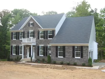

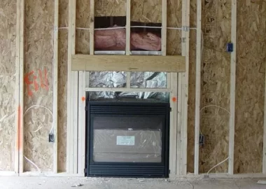

I think it's a pre-fab gas fireplace... here's a photo of it when the house was being built, also I've attached a photo of what the chimney looks like from the outside. It's one of those half chimney's that are framed like the rest of the house, and NOT masonry.

You can't put any insert into that. Looks like a Lennox direct vent gas fireplace.
Your only easy solution would be to tear it out and put in a Pellet Insert (installed as a built in unit). Those can be vented out the back like the gas unit is.

1. You CAN NOT install an insert into the current setup. An insert is intended to go into an already existing masonry or (sometimes) pre-fab WOOD fireplace. It would require major (spelled Expen$ive) work to put enough of a structure in to install an insert.
2. There is practically nothing of the existing structure that is useable in it's current form to put any sort of replacement prefab ZC fireplace in. The bumpout shell might be big enough, but not likely, and it would need serious modifications to use it.
