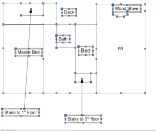

If you know of a simple program I could use to create my second floor layout, I'll glad put up a drawing. The original house was built in 1869. The garage/FR were added in the late 70s. The doorway leading from the FR to the main part of the house is a 77" X 31", and it opens into a hallway along the front of the house. A stairway leads to the third floor, and another doorway leads into a bedroom. At the end of the hallway is a playroom which connects to the another hallway with the bathroom and the master bedroom. Not your typical layout by any means.

Will have to think about this one. Sounds like a challenging area to heat from the FR. Have you ever tried putting a small fan at the top of the third floor stairway, pointing down the stairs? Then a fan on a table in the hall, or on the floor, the far side of the stairs, pointing toward the family room, with the family room door open; might work to force some air from the room.
So, the FR is on the second floor, and you are hoping to heat the bedrooms and playroom to some extent with the FR stove, and are not worrying about the first floor? Is that correct?
What I would do is try with your present stove every concievable reasonable way to try to move heated air out of the FR. If you come up with a method that works, then I'd get a bigger stove, like the Progress Hybrid, or at the least the Fireview of Keystone. . If you find that no matter what you do, you cannot move heat effectively to the other areas in your home, then there is no reason to oversize for heating the one room, and I'd go with a smaller stove. If you are really only heating the FR, you can probably go quite small, and use a good deal less wood.
You mention that you have gone from one to two cords per year with your present stove. If the stove is suitable for you in every other way, you might want to check and see what would be involved in refurbishing your stove. Do you only need gaskets? Recementing? Woodstock rebuilds Woodstock stoves, they might rebuild your stove for you. Don't know what it would cost, but might be worth inquiring. Nothing lost. If the stove is a good one (I know nothing about the Soapstone II), it would be a shame to retire it.
Rich and I were writing ata the same time. It really does not sound to me as if you are going to be able to realistically heat a lot of that 2000 square feet, as it sounds as if a lot is down some hallway and then downstairs? So I don't think you should be necessarily be thinking in terms of your total square footage. That FR is not located at all centrally, or where it will be easy to move a lot of air. Again, try mving air in your current set up. A new stove will not change your ability to move air, although it may change the quantity of heated air available. How big is the Soapstone II?
Not really looking to heat the playroom. Some heat does go up the stairs to the third floor today. It's not a major requirement. The first floor is out of the question. As soon as I can draw the layout of the second floor, you'll see my challenge. Only reason I put the total square footage is someone asked.

I put together a rudimentary drawing, but it failed. Standby for a drawing.

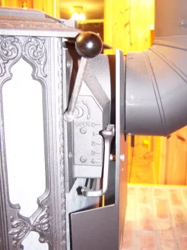

When I go to the WoodStock site, I don't see on either the Fireview or the Progress Hybrid where you control the air from. Unfortunately they don't offer a 360 degree view. Although I could be looking at it, and just don't see it in the picture.

Yes, a lot of us are pro-Woodstock and it is because of the type of company they are and their stoves are fantastic. But you have me here. I looked through my pictures and can't seem to come up with a decent picture showing the controls. On both the Fireview and Progress the draft control is to the right of the firebox door. That is, toward the rear of the stove. I can see our stove from where I am sitting and the control is set at about .75 (draft goes from zero to 4) and the lever is just about even with the top of the firebox door.
You can choose many different colors for the trim and the one pictured is a bit plain. Ours is metallic brown. Charcoal really looks nice too. But there are many colors to choose from. If you are lucky enough to visit the factory they will show you how they are built (which is impressive) and you can also go as far as picking the exact stone you want for your stove. Hope this helps.
