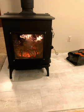

overall, an improvement I think. big thanks to all here, would have been a much more difficult process without yinz.
The new hearth looks great, matches the stove very well, especially with the accents around the edge.
Is that a single wall 7 to 6 reducer attached to double wall 6 stove pipe above? Do you need to find a double wall reducer?
thanks. fortunately my friend Martha is pretty good with a trowel!
the reducer looks crap because I had managed to buy the wrong size first time around -- caused a little drama when the installer was here, fortunately the local Ace had a serviceable one, which he'll replace when he comes to sweep. it was a b#tch finding someone qualified, RI is really underserved with qualified sweeps/stove technicians.
