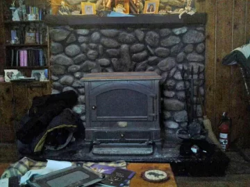

Hi guys, been about a year since I was here last. The time has come that we need to replace the Efel harmony in the fireplace. We are still notdecided if we want to go with an insert or another hearth stove, but we are leani g toward a hearth sstove. We are on a tight budget, about $1000 give or tzke, so that is a limiting factor. We are also limited because a stove would need to be rear exit with the top of the pipe no more than 26 inches which is the height of the lintel. I am having trouble finding budget stoves that meet my height requirement and ive found most dont even give that information. Im not against used buti needsome ideas of what to look for.
Also, capacity isnt really a big concern as it onlyheats the living room and one adjacent bedroom and evdn then, only in really cold weather.

Pic of setup

Keep an eye out for a used Jotul F3CB.
PS: Is there a hearth extension protecting the floor?
The budget stoves are mostly top-vent only. But that's not much lintel height either, so you may be in insert territory. On stove makers' websites, they should have a "specs" section or diagrams with the rear-exit centerline listed on the page for a particular stove. I would prefer a hearth stove as well. I have 28.75" to work with, and freestanding stoves that will fit are pretty scarce. You might be able to top-vent, then go into the chimney several feet above that..but it would detract from the great look you have there now.
Good call, would squeeze under that lintel and provide enough heat for a couple rooms.
Yes, there is an 18" hearth extension. I dont use the front load door anyway, and the install was permitted and inspected a couple years ago.

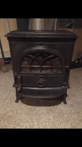

What is a jotul fireplace stove 3 ? Would that fit in there? I wish people would give better info in their adds.
Sent from my GT-P5113 using Tapatalk
Maybe the same stove or it may be its predecessor. Got pic?
[Hearth.com] Replacing fireplace stove.
I see three of these for sale local. This one and two white ones. All advertised as “jotul number 3”
Are these stoves convertible for top or rear vent? I am seeing them for sale both ways....
Like this one, can it be converted to rear flue?
Also, this fireplace is one of those metal firebox types sitting inside masonry with a masonry chimney and 13x13 clay liner( with a 6" stainless liner inside that) can an inset be put in this fireplace at all?
