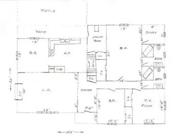

Hi. You folks seem to know the score on all this, so I'd like to ask your collective opinions. Last year I bought a 58 year old house outside Pittsburgh, which still has it's original gas furnace, rated at 180,000 BTU input, and about 70% (!) efficient. I knew of course it would have to go, but in the meantime, I've been considering my options. Heating with wood though has caught my interest, for the same reasons people here already know. The house is a ranch style with 1900 SF on the main floor, plus a large walkout basement and garage underneath that are not officially heated. I'm attaching a floor plan to this post.
My expectation would be, given the floor plan, that a single wood stove in the LR would not be enough. The hallway leading to the bedrooms and bathrooms is perhaps 30 feet, with the two bathrooms at the tail end. So I'm thinking that a smaller stove might need to be placed in say, the Master?
A heat calc for this house at design temp yields between 32,000 and 38,000 BTU/H, depending on whether or not I insulate over the basement areas with at least R5. The ceilings are all 8 foot, with R30, and R15 in the walls.
The current furnace and it's ducts need to go, as they take up a huge amount of space, and the ducts are in the backwards "old style" anyway. So when I'm done there will be no heating system left. I'm assuming though that even if I put in wood stoves, that a secondary heating system is needed as well, to make up for the coldest days, and for when i'm away from home?

I believe it's against code to have a wood stove in a bedroom. I see you have a fireplace? Are you looking at a fireplace wood stove insert for it? If so get a large one with a blower to help circulate the heat. You may have to play with fans to get heat into those far bedrooms, maybe a box fan on the floor in your foyer directed towards the stove will suck the cold air from the bedrooms and the warm air replace it.
Another option since your taring out the old furnace and ducting is to look into a wood/electric furnace. Check out these EPA certified furnaces. www.psg-distribution.com
As you've noted, there's lots of room for improvement. It sounds like you are taking the right approach. You might consider going with a zoned, gas fired (or wood/gas), hot water system instead of forced air if you are starting off from scratch and air conditioning is separate or window units. It's good to have a backup system for sure. People get sick, go on vacations, or just want to get away for a weekend. So do have a good central system for backup, especially for when it gets very cold.
It will be a challenge to keep the bedrooms cozy with wood heat, especially the master bedroom. But the core of the house shouldn't be a big deal assuming the house is not a leaky sieve. Is the basement finished and insulated or not? What are the thoughts for heat there (or not)?

I don't have a fondness for exterior chimneys, but with an insulated liner and blockoff plate you can make this one work. There is the option of putting a freestanding stove on the hearth in front of the current fireplace to increase heating efficiency.

I see your point about the basement insulation. The rim joists and sills are all open with easy access, and it was my intention to airseal and insulate them before this winter. I will insulate the basement walls as well with fiberglass, though the slab will always lose a lot of heat, so I was toying with just insulating the basement ceiling instead.
BTW--there is an equally large FP in the basement, below the one in the living room. Does that create any opportunity?
