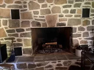

Good Day, Working on replacing older firebox. Is the Montecito Estate, that lists at 79%, the only ZC fireplace on the market at this time? This is what I came up with after research, but wanted to verify. Hoping I have more choices, but maybe not. I will post more details on sizing and venting, but wanted to see if anyone could provide some guidance on what ZC firebox's are on the tax listing. I can not find any but this one recommended from Begreen awhile back. Thanks, Dave

That appears to me, a complete amateur, to be a masonry fireplace. Am I wrong?
If I am correct you want to look at inserts unless you are demoing it all and starting over.

The firebox and damper are completely rusted out. I am not to sure which one one work best. If an insert is the correct way to go, I am all in. I am under the impression that the old firebox would be cut out. Maybe I am missing something. Less demo the better. Thanks for the clarification.

I better hope it was a masonry fireplace, given that fires were had in that hole...
Funny uneducated use of a stone like a keystone above the fireplace...

Has been burning for over 40 years I bet. And yes, 100% masonry, PA Blue Stone I have been told. Is that even a stone? You can see why it needs some work. Looks like an insert is the proper unit with a new SS chimney flue. Agree?

Yes

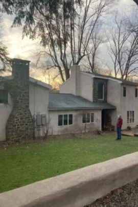

Here is the outside of the chimney - 15' tall.

it's short; most stoves and inserts require a minimum of 15'. So be aware when you look for an insert.

Will do, I am a stove guy, so this insert market is new to me. Tax credit is important (75% eff), chimney height I suppose could go a bit above current stone with extension. CAT vs no Cat, large fire box, hearth extension, viewing area. Will learn along the way, thanks for your help.

Looks like a heatform style firebox. An insert (not ZC) can go in there if it fits. An insulated stainless liner will be required. BK inserts qualify for the tax credit.

If the fireplace has a rough stone face it might be better to recess the insert slightly and do a custom shroud that is inset from the fireplace face by an inch or so. Otherwise, an extension can be made from stiff steel (say 20ga) and painted satin black. The large shroud is 32 " x 44 " so a 5" extension would work.

Yes, I was thinking @2.5 custom on all sides. When you say set back in an inch, that would still require the @2.5 custom, correct? You can see by the picture on the OP that I have plenty of depth with the current firebox and stone wall. I like the idea of setting it back in 1 inch. That would require "caulking" or not, between the outside stone and the insert setback? I also would think I should look into insulating the firebox as well?
