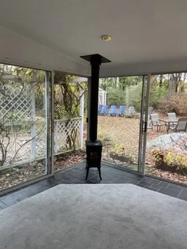

Hey guys - three weeks ago I had an F602 installed in my sunroom. The place I bought it from told me it would heat it without any issues. It didn't.

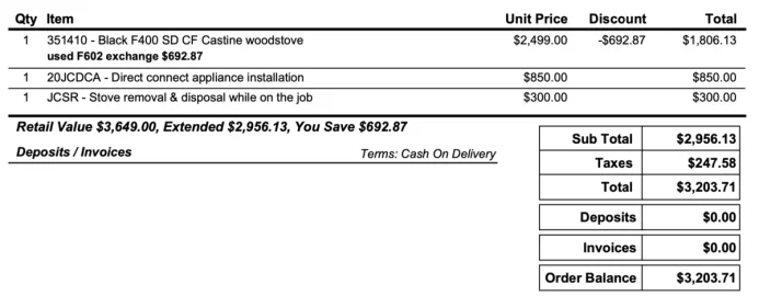

I called the place I bought it from and they said they would take it back with a 25% restocking fee, and apply it to my next stove, the Jotul F400. However they seem to be charging me an arm and a leg for the installation and stove removal; and I'm not sure if I'm getting ripped off or not:

Nothing new added, and they said they can use the same flue. The F602 will heat up the room, but I have to restock it about every 2/3 hours to keep it hot in the room. In addition, because its small, I have to cut the logs in half to fit, or use wood which has been broken up into large kindling.

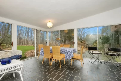

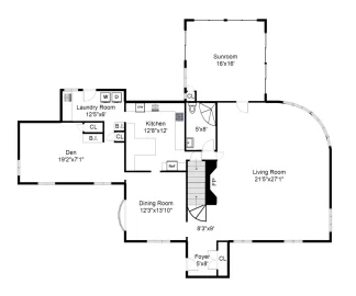

I've attached our blueprints, as well as photos - its 3 sides of glass. I'd hate to have this installed and still deal with issues.

That's all glass, it's not going to hold heat well. 2-3 hr reloads are not bad for this stove. That said, you can use a larger stove without consequence. Worst case scenario open the sunroom to the house. My only concern is that the Castine may not perform to great with that chimney. The Castine likes a good strong draft and at least a 16' ft flue system. The flue system doesn't look much taller than 13'. Also, did they put a brace on the chimney pipe? It needs one.
The prices they are asking are ridiculous for an easy swap out like this IMO. And you should be able to sell the 602 for at least twice what they are offering. I don't understand why they would be charging $300 to remove a stove when they are installing another, especially considering it is only a few weeks old and bought from the same store. Consider hiring a certified chimney sweep to do the change out instead and think about other stove options that may work better with a short flue system.

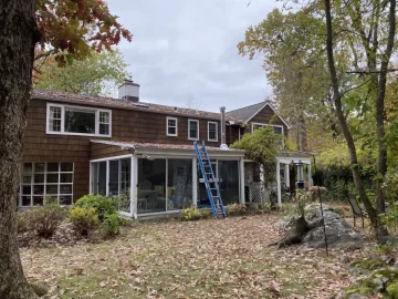

You're right on the 13' - Its 6 on the outside and 5 on the inside. Makes me think that its not worth it - especially if the flue wasn't be tall enough.
Did they put a brace on the outdoor section of the chimney? It must have one at the 5' level.
IMO, there are some big expectations/misunderstandings on the OPs side of this transaction and the dealer is just padding their estimate to make a second profit on the job. Unless its in writing as for the suitability for the intended purpose, the dealer is probably not legally liable to do anything. The dealer has already made one profit and if the OP wants to give him another one he will take it and hope the OP goes away. There really is not enough details on what sort of guarantee was made on the suitability of the stove. A 602 is a radiant space heater designed to heat a space as long as its fed wood. It does sound like it can heat the space, its just that the OP is unhappy that he is not getting long enough burns. If the OP is trying to heat this space 24/7 its a fools errand.
In my opinion the proposed replacement is still not going to deal with the fundamental problem that the sunroom has incredibly high heat loss. Except that it has a ceiling, its worse than heating a garage due to all that glass. My guess without running calculations is that the heating loss out of this space will probably exceed the rest of the house. There are three types of heat loss, convective, conductive and radiant and this installation flunks on all three. its a three season sunroom at best and trying to heat it year round or use it for supplemental heat to the rest of the house is a fools errand. Looking at the photos, the sunroom appears to be an older installation possibly 1970s when energy efficiency was not an issue. I wonder if there is even insulation in the roof?. If the sliders are double pane, the R value at best is probably in the 3 to 4 range, if they are single pane at best R 1. They look to be older sliders so the infiltration rate is quite high. I dont see any thermal shades so when the outdoor temps are lower than the indoors the radiant loss and convective loss is sky high out of glass and expect the infiltration loss is also significant. Even if a stove is large enough to effectively heat the space, the amount of wood its going to need will be a lot, several cords per season and the reality is its just going to be sucking in so much air that its going to be pulling heat from the rest of the house. Its looks like a concrete slab floor probably with no edge insulation or insulation underneath so its going to be sucking heat out into the ground continuously and will take hours to warm up. Barring major renovations and substantially reducing the amount of exposed glass in the space to reduce the heating load I do not expect any wood stove is going to meet the OPs expectations. In my opinion keep the 602 and realize the space is never going to be year round space unless its torn down and a energy efficient structure is built in its place with far less glass. At best if its needed in cold weather plan on firing the stove while its needed and let the space cool down until the next time its needed.

Just looking at your pics I would never buy such a small stove for that space. The dealer should have known better. If they were any kind of people they would take it back and give you a full credit toward a bigger stove. They probably arent and obviously wont. Shame. Maybe sell it on Craigslist.

As far as the price - after negotiating with the dealer, I got $600 knocked off - which in the end was realistically the best I could do, especially as there are no other Jotul dealers around.

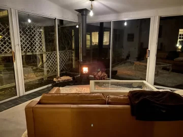

First impressions - LOVE not having to keep refilling it with small logs. Having the ability to load it up with actual sized (16”) logs was fantastic! It heated the room fast and hot - and lasted about 4 hours on low vent with 3 medium sized logs in it and an outside temperature of about 43 and rainy. I’ll have a detailed analysis later tonight when I measure the time, weather and usage.
