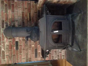

If you can post a picture of the current installation that will be helpful.

Attached is a pic of the current setup we have with the Vigilant. The facing has whole bricks as an fyi.

I'm going to recommend that you consider the Quadrafire Isle Royale unless you want to extend the hearth protection for the side loading Jotul Oslo. See if your sweep can answer the questions I have about the chimney.
It's a top and front loader, has 3 cu ft capacity, breathes easily (draft may be an issue depending on the current chimney flue size), radiant like the Vigilant, very good track record, and looks beautiful.
