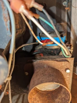

The pressure/vac hose seems to be missing when I got the stove. Both cables are connected but I can't locate the tubing nor the space where the tubing connects to the actual stove. This an older p61 (with the micro switch) that I have been trying to bring back to life and I have no history on it. When I bypass the psi switch by using a jumper the stove operates "as it should" on the test mode. If anyone would happen to know where the vac hose goes that would be great. I've spent over 2 hrs trying to locate it and the only thing I found is what appears to be a solid plug with nothing hooked up which would make no sense to do that and still have the psi switch wired. I tried to show that in the pictures. Any help would be greatly appreciated. I also looked on YouTube and got nowhere.

I looked all over the fresh air makeup area and nothing. I found that one out of three bolts holding the combustion motor is missing....maybe it goes there but that doesn't make sense as well. I'm stunned.
Here’s another photo, I felt the vac hose and where it attaches, it’s down to the left of the switch and the nipple maybe broken off on yours

here’s another photo I found and you can see where the vacuum line attaches to the stove, doesn’t look like there’s a nipple, and like mine it looks to be siliconed into the stove. I’ve never had mine off so can’t say definitely
[Hearth.com] Restoration of Older Harman p61 -help with pressure/vacuum line location.
Hi again and thank so much for taking your time. You are correct. I found it and there is no nipple but it seems like the tube is just stuffed in there with silicone around it. Not sure if that was done originally but I will try to drill the remaining tube out and get creative. Thank you again!

Not a problem, keep the updates and photos coming…and it looks like that’s how the hose attaches in every photo I’ve come across
Got the piece of tubing to go through as I couldn't get it out. No signs of the nipple but it had silicone all over the area. I will post another pic when I get the tubing. Thank you again!!!
