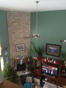

Currently, I have a 6' wide by 18' tall fake stone faced corner wall. It is hollow space behind the fake stone facing other than the gas unit in the hollow area. There is a wood mantel that is about 55" above the floor in the middle of the stone faced wall. Based on reading (and the wise words of Begreen) it seems like the best option for efficient heat with a real wood fire, I think a ZC fireplace unit would be our best unit to install.
We plan on removing the stone face wall from the mantel down to the floor and removing the gas unit. We will frame up the area correctly to install a ZC unit, install the double lined chimney behind the stone wall and through the ceiling above to the correct roof height. Then, we will rebuild the stone face and mantel below the tear out location. The mantel will now go full width and we are considering having the stone a completely different color versus trying to match the old grout and stone that was there. In essence it will look intentional.

Here is a picture of my current setup. Also, the stone face measures 76" across. We are thinking we will build a wider stone face below a new mantel to allow whatever size unit I want...

We do a few of these every year. It's pretty straight forward, although messy. Your first bid was right on track, expect to pay $5K-$8K for something like this depending on the unit you pick. We often do the Kozy Z-42 in an instance like this.
