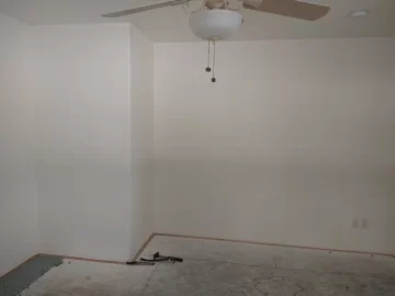

I have the idea in my head of how to go about this but I figured I'd ask to make sure I'm not missing anything. Always hate finishing a project the realizing "I wish I would have done that" .

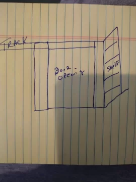

Anyhow, I have a room with no closet. The jut out in the picture is a bathroom on the other side of the wall. I plan to extend this down the wall about 5 feet. No room for a swing out door. I wanted a traditional bifold door but I lost that argument so it's going to be a sliding barn door with the track extending down the wall. On the right hand side of the closet she wants book shelves built it. Once the opening for the shelves and door is cut there won't be much that needs sheetrocked and textured. I plan to just use spray can texture. I've had pretty good success with the oil based version before. Excuse the art but the drawing is more or less the plan.
See anything I'm missing?

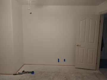

Got the door already. Actually have had it 2 years waiting on this project. They had a sale on them at Costco a few years ago for $125 so that actually sparked the idea. The space is 27" deep discounting the 2x4 frame and sheet rock. I can get 5' long + another 10" or so for the shelves. The problem is the door opens there as well. The tape in the picture is 5' and 5'10". This is the only wall I have to work with as the room is on a corner and has windows on the other walls. I don't like the look of opening a door into a wall but figured the bookshelves would okay rather than a blank wall.

I have seen smaller closets. Should be fine. Usually want at least 24" depth if hanging clothes.
Makes much more sense seeing the rest of the wall.
Anyone coming into the room will have to take it easy in case she is pondering the books on the shelves. A picture or wall canvas would be an alternative if you’re looking for something other than a blank wall.

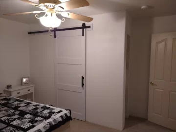

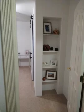

Looks like it was supposed to be there. Built in shelves look good.
