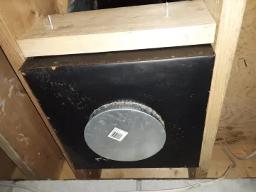

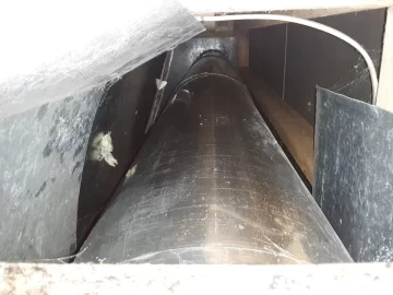

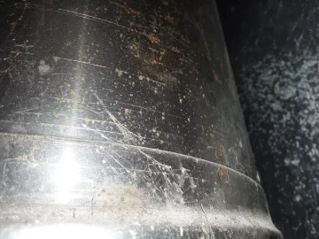

Attached are a couple of photo's that include the capped end and a peek into the chase. I'm unable to locate any labels or see any stamped information. Would be great to determine if this is 103HT, inspect and reuse.
If I removed the cap (it is silicone sealed in place) might there be any stamp or labeling at the connector?
Is it permissible and safe to install a 6" flexible liner into the 7" core?
Thank you
John

It may be ok, but we can't tell from the pictures. This may take some experienced eyes on site to inspect.
