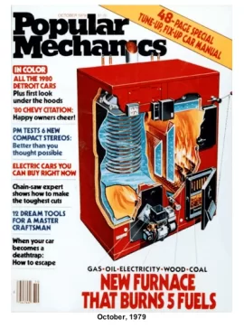

Introducing air on the oil side would not seem to do anything as it is a separate chamber, but I could imagine some scenarios where you could tune up the unit. You can buy replacements for that control......again, from Tarm...or other sources (boilers) that use similar controls. The insides were not bi-metal, rather these were liquid expansion - and very accurate. You can probably also get them from EKO since their coal boiler uses the same type.
Using a good chimney...or possible a chimney draft inducer (pulling rather than pushing) might be one good way to get the thing burning more efficiently....that boiler does use a crossdraft of some type - when you move the bypass in the right position.
Maybe we have an OT user here who can get you a manual if Tarm cannot.....but try them....and let me know what you come up with.
The enclosed cutaway might help you with understanding the interior.

Thanks very much for the info. Since I posted the message I got a quote back for a new Samson control valve for $150. Seems rather steep considering what it is, so I am looking for alternate sources. Also, I have found a copy of the Oct 79 PM magazine on Amazon and intend to read it over to get a general idea of what it was supposed to do 'in the day'. I am in the process of cleaning and reassembling it so I can pressure test the thing before I go much further. Thanks again, any other help and advice is appreciated !
