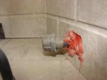

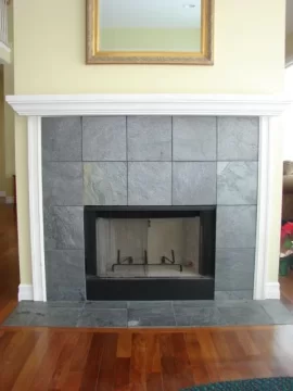

Here are some pics of my existing fireplace and gas pipe.
  • [Hearth.com] Rip out existing ZC fireplace, and build a alcove for free standing pellet stove.
existing fireplace.

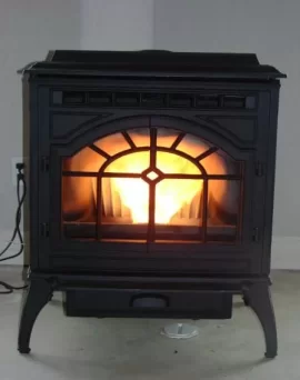

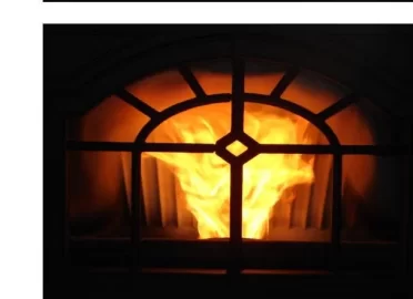

Pics of my Mt Vernon in basement.
