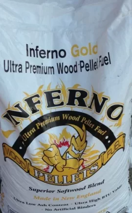

I couldn't help myself last night at blowe's. I grabbed a couple bags to try. They look like a blend pellet with a "softwoodish" smell. I will get some pics and a test burn this weekend sometime. For some reason my cheapo stove loved the Curran/North Americans last year but I don't have any left to compare to though.

My point was the bag says 100% softwood so I don't think they are Currans.
Read the bag again. It says superior softwood blend!
[Hearth.com] Robert Kraft Gold...
It also says "Made in New England" After a closer inspection today, I think they are MWP. I knew the smell was familiar last night, but today after filling the hopper with them, it dawned on me.
If you look at the PFI bar graph and compare it to North American/Curran and MWP, Which is it closer to?
As usual you are correct. I think in my mind that meant that it was a blend of softwoods so I assumed it was 100% softies....
Awe come on, I've been wrong lots of times!! ;)

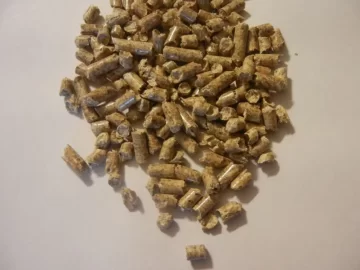

I'm pretty sure these aren't MWP
Reactions: jtakeman
I think I am gonna open a pellet DNA lab.
Just got back from a dog food run to TSC. They had an open bag of MWP for 4 bucks so I grabbed it to compare.
EDIT: oops I forgot the "N"

Does the PFI box have a Mill Registration #?
Curran's is 16004
I'll have to ask for help. I didn't buy any of the Inferno Golds. BigY wanted way to much for them. So if anyone has a bag can you check this or post a pic of the PFI label on the Inferno Gold bag for us?
MWP has a PFI label, But no Mill reg number is listed.
Interesting if we could track by the mill reg numbers, But like the UPC codes. They could still be using the original Inferno number?

The Mill Registration #'s are unique to the plants certified to the "new" PFI standards:
16001 - AWF (hardwood): Circleville Ohio and Marion Virginia
16002 - AWF (softwood): Circleville Ohio and Marion Virginia
16003 - NEWP: Jaffrey NH, Deposit NY, and Schuyler NY
16004 - Curran: Massena NY
16005 - Marth Peshtigo: Marathon Wisconsin and Peshtigo Wisconsin
16010 - Forest Energy: Show Low Arizona
03304 - Lignetics: Linn West Virginia
03434 - Lignetics: Kenbridge Virginia
03208 - Lignetics: Sandpoint Idaho
