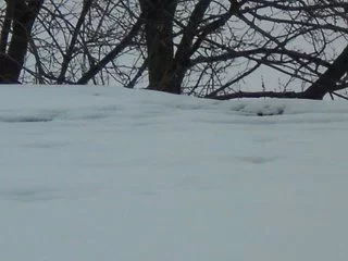

Inspecting it from the ground just now, I can see some very obvious and interesting
anomalies in the snow. It looks like a couple spots where heat may be escaping and melting the snow
thus giving away the location of the leaks. But alas, I can no longer risk crawling
on snow covered roofs.

It starts leaking. I go into attic to check drip pan.
I notice some mold about eight feet away leading to where it drips. I go out to look at roof.
There's about three inches of snow evenly smooth across the roof but wait a minute,
at about that eight foot mark, there's an obvious hole in the snow.
Yes I got great pictures but can't seem to get them up.
There's a couple smaller holes up the slope from other leaks.
I believe when the snow melts, I can go up there with an IR gun and find heat escaping from the attic.

Let's get the pictures up. This might just be an isolated defect. We also need to get your DIY problem taken care of. That's where this post should be for the best responses.
You can PM me or email me with the pics if this is just a tech issue. The help file for posting pictures is here:

Moderator- Move to DIY if you deem appropriate.
  • [Hearth.com] Roof Leaks & IR Thermometers
Moved. Is there a ridge vent on the house?
We have a IR Camera at work and it is amazing! Our flat roof leaks like a sieve too (Despite being very new). You could find a leak with the IR themo too, best results are on a cool evening after a sunny day. Mositure under the roof will stay warm for a bit.
Sounds like ice is damming up at the angle change area between the 2 roofs. As there is no penetrations, it is either ice damming, or a hole or holes. Follow the mold, and that will show you were the problem is.
