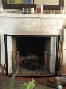

Hi all, I've got a narrowish, frustrating, smokey FP in a small (<1,100 sq. ft.) single-story house, and after taking down several trees on our lot, I have ~2.5 cords of dry stacked hardwood just waiting to burn! So I'm interested in adding an insert to allow us to make use of our resources--and just to enjoy the FP we've hardly ever been able to use.

How tall is the chimney? That might be part of the issue. If it is short then it could be an issue with an insert too. Take a look at the Pacific Energy Neo 1.6 fireplace insert. The blower on low speed is pretty quiet. If you can post a picture and the fireplace dimensions we may be able to suggest other inserts too.

Thanks! Dimensions are 31W (front) x 29.5H x 19D narrows to 22.5W at the back. Chimney height TBD. Photo attached.

A little freestanding stove like the Hampton H200 or Jotul F3CB would have fit nicely in there, but it might take some searching to find one.
That fireplace is screaming “Morsø stove”!
I can distinctly hear it from here.
So... ballpark our chimney is ~11.5 ft. from the top of the FP to the spark arrester. Pretty short, but then again, pretty tiny house.
That was my concern. We have heard complaints recently with a Morso stove on the same height chimney. That is why I suggested the Hampton which breathes a bit more freely. Still, I think you may need to extend the chimney to get best performance due to the mild climate in your location, regardless of stove or insert choice.
