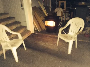

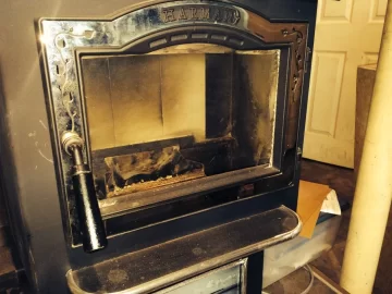

I have a 60's split with a p61 in the center of the basement with 2 registers cut. The p61 in the garage is just backup if I needed it which I really do not. Just nice to have if I want to work in my short sleeves in there in the dead of winter. So just get a p61 for the basement and show us some pics of the install, :)
I also picked up a 25-ep that I am testing for an outdoor Patio heater.
It was a little chili last night but comfy in front of the stove. What do u think?
Do not pay any attention to that Travis Avalon Astoria 45k btu pellet stove to the righ. That is in my "pimp your stove" program where we take out the ho hum stock 1 amp exhaust blower and short single paddle blades and supe it up with a whopping 1.75 amp ball bearing blower and double paddle blades for the best low drafting performance that stove has ever seen. Remember the best low drafter burns a flame a little higher! Sung to the tune "Low Rider"! Then replace the knob control panel with an upgraded digital touch panel and remove the old skanky bronze oilite auger bearing and replace it with space age nylon bearing backed with an ultra high performance GA auger motor and repaint the stove with Surf Sand modern color for the iron fire brick backing!
