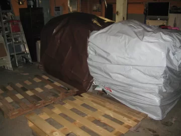

basement is for storage here mostly as awaiting 2 more early buy Tons.
There is a tv, couch etc there but cannot see Heating the Concrete walls and whatever leaks out in order to get heat upstairs.. basement stays around 60 degrees most of the year and summer

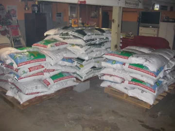

Our basement is finished but only used for storage. Our 6 1/2 tons of pellets plus a few other things are in there. We keep the oil thermostat down there set to 50. Our laundry room, oil furnace, oil tank and garage access is down there too.
Same here....Actually with a jacket on, sometimes watch tv down there in the winter when wife hogs the tv..
Oil Furnace, Laundry also down there..guess u would call it a cellar instead of basement.
Pellets come thru the window off of the truck with a few people involved.
[last winter picture.]
Oil Furnace for DHW] but last years Zero degrees Vortex had us run the furnace at night for a week just in case a pipe here or there decided to freeze up.
basement did drop to low 40's overnight for 1st time in 20yrs. and made me a bit nervous..
Only takes a drafty hidden corner somewhere to freeze up a 90 degree pipe.
saved so much on Oil Anyways so burning a few gallons a night for a week was no biggie.
