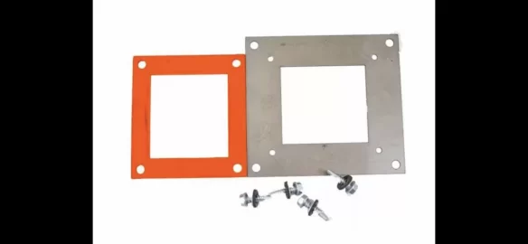

The only blower adapter I know of is for the older Breckwell pellet stoves to put the new smaller convection blower in place of the older discontinued larger blower. See pic, so not really made for what you want because you can’t bolt it in! You can put a larger blower in the stove like the Pelpro 250 CFM blower if it will physically fit with self tapping screws. However if you put more air thru that same heat exchanger, then the air temperature coming out will not be as hot. That does not mean it will not heat the room, you would have to try it and see? :-)

The only blower adapter I know of is for the older Breckwell pellet stoves to put the new smaller convection blower in place of the older discontinued larger blower. See pic, so not really made for what you want because you can’t bolt it in! You can put a larger blower in the stove like the Pelpro 250 CFM blower if it will physically fit with self tapping screws. However if you put more air thru that same heat exchanger, then the air temperature coming out will not be as hot. That does not mean it will not heat the room, you would have to try it and see? :)

I was hoping that a high cfm fan will be less noisy when run slower creating the same cfm mine does right now...
Will try a different gasket...
Thx alot
