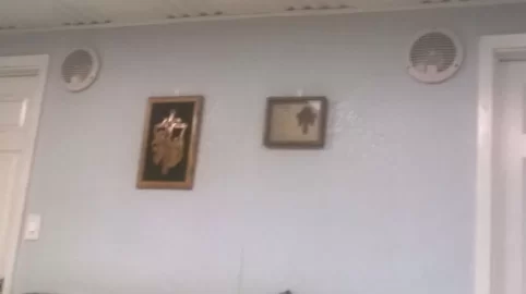

[Hearth.com] Room to Room OR Doorway Fan?
I installed my room to room fans tonight. Took me about an hour. I'll report back with how they work.
