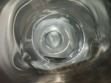

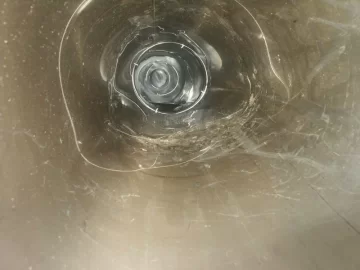

Total I went to install my rigid chimney liner and accidently ovalized a section of it when I dropped it by mistake. I was able to straighten out most of the pipe, but it still had a pretty good bend in it. The bend isn't so much that it will interfere with the draft, but my concern is with the pipe itself. Is the integrity of the pipe compromised from where I bent it and then hammered it back to as round a shape as possible? Should I order a new length of pipe?
here's some pics..although it is sort of hard to see. There are actually two places where the liner got bent. The first bend is much worse than the second.
one pic is taken zoomed out, and the other zoomed in. You can see where I have hammered in the first bend. I wasn't able to reach the second bend, and it isn't that bad anyway.

You might do what Rhonemas did with his flex liner. Stick a 2X6 in it and rotate it to straighten the pipe back out. It ought to be fine.
good idea with the 2x6. I'll have to give that a try. In terms of the pipe, however, you don't think there will be any problem with it? I can't see there being any problem with it, but I just want to make sure it is safe. I can't see a bend like this being an issue with 24 gauge pipe, but then again I figured I'd better ask the experts...

I think I can live with the brush getting stuck a few times. Actually, I cut a board the diameter of the liner and worked it up and down, back and forth, etc. Seemed to get things straightened out pretty well, except for a small bend up high that I couldn't reach. I guess I was really worried whether a sharp bend like this might put a crease in the liner, or even a small break that would go unnoticed. I guess there isn't much chance of this though??
While it is my own fault and stupidity that this liner got bent, this 24 gauge rigid really does bend pretty easily. The flex liner I used in a previous install seemed more durable than this stuff. I know the wall thickness is greater, but it sure doesn't take much to put some dents in it...

Although the flex liner is pretty durable If it is twisted it will break the seals fairly easily, like opening those cinnamon roll containers (sorry for the bad description) but you should be ok though.. However you may not be able to use a steel brush when cleaning the pipe in the future as it may get stuck in the ovalized portion.

I've always used a poly brush anyway, so hopefully cleaning won't be a problem. Plus, it doesn't seem to be too ovalized since I've reshaped most of it back in place.
So in terms of from a safety standpoint, there is no concern?
