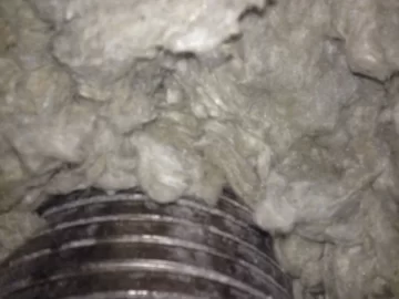

Jetsam, as much as I could without being too rough on the liner, I packed it pretty densely. Should I have not packed it dense? I'd really prefer not to mess with it anymore as it's a pretty nasty job (even wearing a hepa filter mask, I'm still caughing!), but if I am going to fix anything, now's the time. Any cause for concern? Any advice?

Good advise about being careful with the liner Begreen! I don't believe my liner is thin wall - it's a best flex crossover, which I'm told is heavier than a thin walled but a bit thinner than a heavy walled - but either way, I heard your comment in my mind as I was working and was careful not to be too rough!

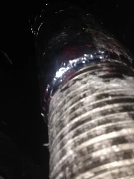

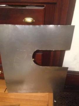

One other thing: the company that did the install and put in the blockoff plate put a thin piece of some white insulation above the blockoff plate. I left that there, but I'm wondering if anyone knows anything about some completely white insulation and if that sounds normal. It looks very different than the roxul and I could remove it easily if necessary- it's only about an inch thick. Thoughts?
Now, on to the sheet metal behind the stove!

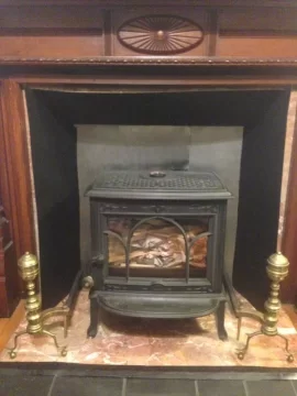

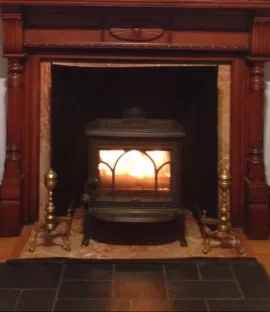

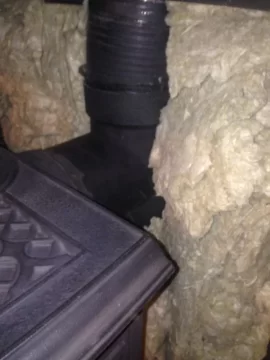

Oh, and here's a before and after pic! (actually got even more roxul after the after pic, but took this while there was still room to get my camera up there!). Note that my liner is insulated, but they cut a bit of the insulation off above the damper to get it through the opening, which you can see in the first pic. Now it's got insulation all around it with the roxul up until it passes through the blockoff plate.
[Hearth.com] Roxul help
The white stuff is kaowool. It's a ceramic insulation and quite appropriate.
Good progress. I'd say don't mess with the insulation up the chimney any more, you did a good job. You can focus on the sheet, I think that's where you'll be getting the most bang for your buck keeping the heat in the room
Nope. Mashed up like that it's worse thermal insulation. It would probably be better if you pulled out enough that it could expand, but I doubt you'll notice the difference. I'd leave it be- just make sure your blockoff plate and liner are still ok.

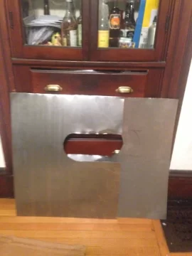

I was thinking, once that big insulated vertical steel block off plate is in behind the stove, the stuff around the chimney will be less important.

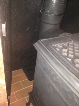

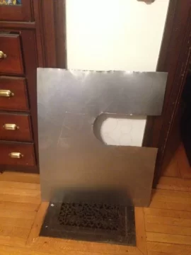

Done! (For now in any case!). Made two steel plates with cutouts that overlap, put roxul behind the plate (just wedged it in the fireplace firebox, so no need to adhere to plate), and put the plates in. Fits well. Going to test it, then I can paint and seal if I don't need any adjustments. Out to a well deserved meal with the fam, and then home to heat it up! Will report more to follow...
[Hearth.com] Roxul help [Hearth.com] Roxul help [Hearth.com] Roxul help [Hearth.com] Roxul help [Hearth.com] Roxul help [Hearth.com] Roxul help
Reactions: Easy Livin’ 3000

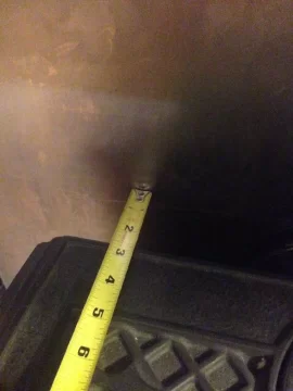

Oh, and one more thing, I've got just about three inches between stove and plate - does that look good?
Looks great. And you might be one of the only ones to use the entire package of Roxul when using it to block off your chimney. Might as well!
I expect that you'll have a much warmer experience going forward.
Well done, and thanks for sharing. Please report back on how it all works for you.

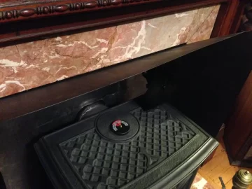

Ok, so here's the update (and any more advice is welcome!). It works!!! However...
I definitely got more heat into the room. It was 37 outside last night and I got the stove room up to a 74, which I had done before but on a warmer day, and last night it held that temp more consistently and kept the adjacent room warmer. I also got a record burn time (perhaps all-time record for the Jotul F100). I got a good fire going and then filled it sometime between 10 and 11pm, once I got a good fire going again, I closed the damper down almost all the way. This morning at 7:30am the stove still had some coals! The stove was at around 200 degrees and the stove room was around 66/67. Upstairs was at 64. Keep in mind, that's about 2000 square feet of a relatively drafty house! Not the coldest night, but not bad, especially for this little stove. I also got the stove to a bit above 600 for the first time, but that could be other factors like the wood and how well I had it filled - I'm still new at this!
Now, here's the problem (and where some advise is welcome). Above the stove got much hotter than before. I don't have a temp gun (getting one this week), but judging by touch, the heat shield was significantly hotter, and the marble surround above the stove (but not on the sides) was very hot to touch and had me quite nervous (I had trouble going to sleep!). The wood mantel was warmer, but didn't strike me as at all too warm for concern, except for that it's touching the marble (see pic) and I worry about the gradual heating up over time and wondered what becomes unsafe. My fingers are good at handling heat, and I could only touch the part of the marble closest to the stove for a few seconds before needing to move off it - what is too hot?
Here are the options I am thinking about -
1) Scrap the idea of the blockoff plate behind the stove altogether and go back to the open fireplace firebox. A bit of a bummer after a lot of work, but safety is first. Hopefully things will still be a bit warmer with the roxul in the smoke chamber above the lintel level blockoff plate.
2) Keep the blockoff plate behind the stove but move it back two to three more inches to give me five to six inches behind the stove (manual says 5" minimum to protected surfaces).
3) My heat shield is attached to the lintel and it is virtually touching the marble. It is attached with magnets and I can easily lower this by an inch by putting some more magnets, which would give me a inch of airspace between heat shield and marble and I would assume lower the temp of the marble. (I may have to move my ecofan forward an inch or so to accommodate if I do this).
4) A combination of some of the above.
Also, the marble above the ecofan was significantly cooler (though still quite hot), so I just ordered one more of those. I also think this ecofan is doing a good job moving heat off stove and into the room, so a second one will be welcome. Not sure how it would compare to a blower, but seems to have pretty CFM airflow according to the stats the company says (280 to 360 CFM). Here's a link: https://www.amazon.com/dp/B0762PR6XT/?tag=hearthamazon-20

Two ideas:
First, a blower or fan. Not another ecofan, they are more expensive novelty than serious air mover.
Second, perhaps the vertical block off plate could be more diagonal. What I mean here is, angle it with more space at the bottom, and have the top terminate where your heat shield begins, assuming you can still clear the stove with an inch or so. Eliminate the horizontal heat trap immediately behind the stove, and hopefully a rising convection current will roll out of the space and into the room.
Both ideas will help your situation.
Like your idea to add magnets to increase the spacing.
Reactions: Mark8 and KennyK
Yes, as noted early it could be 1/2" and it'd be fine.
Begreen, I don't doubt your expertise, but it was a little too close for comfort for me. This could be because the back of my stove is right under the fireplace surround, which isn't very tall (30 inches and stove is 22.5") and the marble was getting very hot. I could be wrong about this, but I think that with the metal plate so close to the back of the stove, it was extra hot right in that area. I moved the plate back a few inches more so I now have about 5 or 6 inches from the back of the stove, which is still far less space for hot air to collect than with the open fireplace firebox, but gives the hot air a little more space to disperse (at least according to my amateur scientific theory!). Out of curiosity, however, if the stove manual says that it should have 5 inches clearance to a rear protected surface, why do you feel it's okay to have less? Is a block off plate behind the stove not what they would refer to as a rear surface?
Reactions: Mark8
