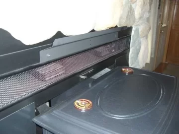

I have been using tin foil on my gauges for a few seasons now and it does work awesome...
